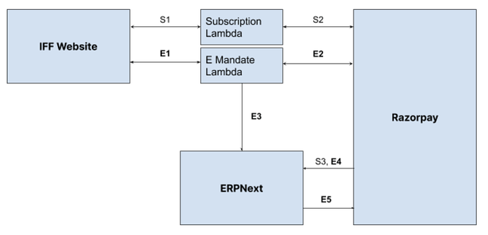

The following is the e-mandate flow marked E1, E2, E3 in the diagram
- Member details are sent to E Mandate Lambda
- The lambda calls Razorpay with the details, which generates a token and returns it back, which is sent to ERPNext and the IFF Website to trigger payment
- Once the token is received we pass it along with the generated customer ID to ERPNext which stores the details for future use
- The token has to be confirmed by the bank, which takes a while to process, when it is confirmed a web hook is triggered which ERPNext listens to, and updates the token status in it’s database
- Following this, every subsequent month, depending on the plan the member is on, the payment is triggered via Razorpay API from ERPNext
